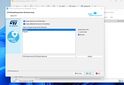

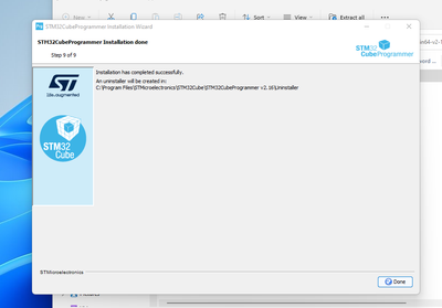

Hello @Soner23,
Just wanted to follow up,
For now I am not able to reproduce on my side, below you'll find some relevant screenshots:
If you have any other detail on your setup, do not hesitate to share.

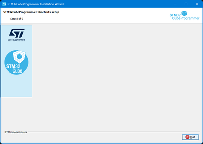

2024-05-20 4:06 AM
In your first image, I don't see the screen. In step 8, the screen appears blank.
