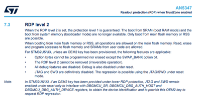

1. Does the STM32U5 microcontroller support reversible RDP Level 2?
2. I have attached the steps we followed - it appears that RDP Level 2 is being unlocked, but afterward we are encountering a DEV_TARGET_NOT_HALTED.
Could someone please review the steps and helps us resolve the issue?

Hello @Gaurangthaker ,
Make sure to update the STLink version.
Please follow the steps and recommendation described in this article : How to regress from RDP level 2 to RDP level 0 on the STM32U5 series

We have followed the same procedure and thoroughly reviewed each step. Additionally, my ST-Link firmware is up to date. Please let me know if there are any other steps I should follow to resolve the issue.
Did you try Connect Under Reset mode?
Refer to AN5347 and check the steps described in section '7 Readout protection (RDP) when TrustZone enabled'.
