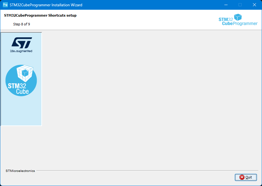

Stm32cubeprogrammer installation does not proceed to the final stage, it remains at step 8 and is not completed. I tried the program on three different PCs with administrator rights, the result is the same, the installation does not complete.

Hello @Aziz BRIGUI
Let me share an update on the issue.
I tried to make a fresh installation with English (USA) Language Windows 11 and install the program, it was installed without any problems.
My computer's language is Turkish, I added an English language pack to this computer, then I tried the installation again and it was installed without any problems.
Turkish I cannot complete the installation with Windows 11 and Windows 10. I hope you can solve this problem as soon as possible.

I tried to reinstall the program after formatting, the result remains the same at step 8 and the installation is not completed. Note do not install any anti virus software.

Look in the installation directory. If the binary files are already there, you can kill the installer and just run the CubeProgrammer from the install directory or create a shortcut manually.

Yes, I am aware of this, the program runs from the directory even if the installation is not completed.
What I'm curious about is that I always encounter the same error when I try it with different versions and different computers, or that many people experience this situation but the problem cannot be solved.
