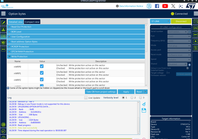

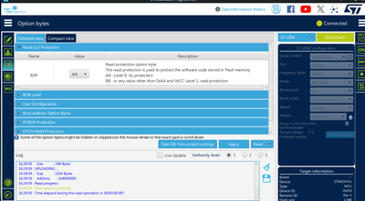

2025-07-04 12:34 AM - edited 2025-07-04 12:35 AM
So connect it with CubeProgrammer, then check:
- rdp level (do nothing here !!! just look, and show screenshot)
- option bytes
-> look at all blocks, there might be some with write protection active; set them to not protected.
Then try program/flash again.

2025-07-04 7:34 AM - edited 2025-07-04 8:28 AM
I dont know, what you try to do...
just connect with CubeProg , then see OB ...option bytes:
...then check for write protected blocks:
What you using to make the program ? CubeIDE ?

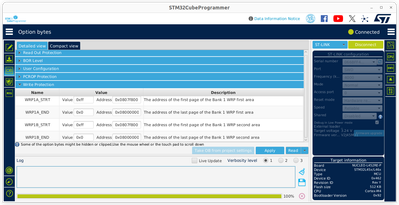

2025-07-04 9:59 AM
So I finally read through section 3. From what I can tell, for each protected area, the settings are as follows:
Area A Start Page Offset 0xFF
Area A End Page Offset 0x00
Area B Start Page Offset 0xFF
Area B End Page Offset 0x00
So taking these settings literally, I see that the start page is after the end page for each area. This is an impossible situation in my view - perhaps that means that there is no protected area defined but I'm not sure. RM0394 doesn't seem to say how to disable all flash area write protection. Should all the registers be zero? Should they all be 0xFF? Should they be as set above? I have no idea.
2025-07-04 10:02 AM
...hmm... i dont have this L4xx cpu, so i dont know, how the protection is to be set. Seems bit different to my Fxx, Hxx cpus.
So look at the rm , how to set unprotected state.
