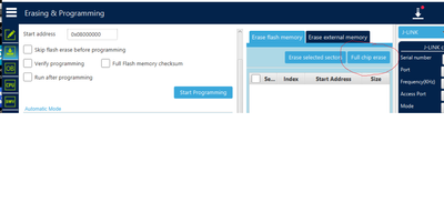

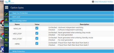

I fixed the broken PCB, when I looked in the Cube programmer GUI the option byte nBFB2 was not set so it would boot from bank2. When enable this option and also did a full chip erase everything was working just fine !
Why I could still flash it with the segger debugger (in bank 1 ?) and the program would still go to the main , but then only crashed when it wanted to init the HAL is still a mystery to me.
