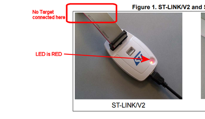

The LED on the top link is red. Is it a problem with the connection or the driver? I can't figure it out. Can you help me?

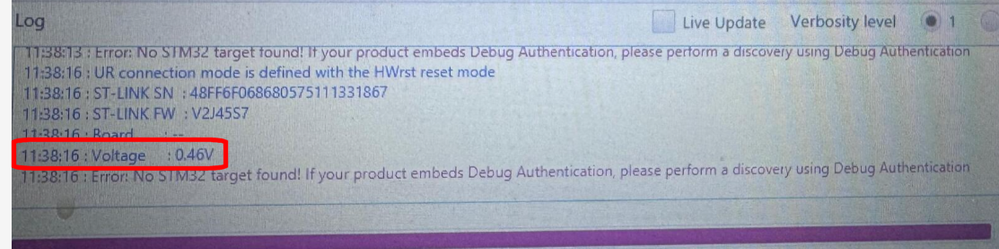

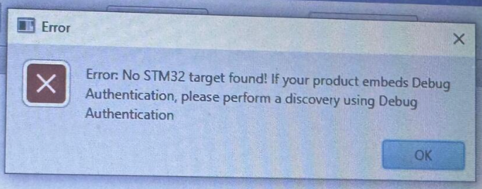

The pop-up message is telling you that it can't detect any connected STM32 target device:
The log shows you that the target supply voltage is only 0.46V
Your Target can't be running with less than half a volt supply!
You need to fix the power supply on the target.
Note that the ST-Link/V2 does not supply power to the target.

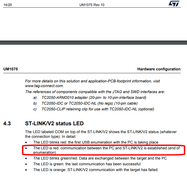

The meaning of the LED is described in the User Manual:
So the PC is communicating with the ST-Link, but the ST-Link has not yet had any communication - successful or otherwise - with the Target.
As described in my previous post, your ST-Link can't communicate with your Target because the Target has no power.
The ST-Link can't distinguish this condition from simply having no target connected at all.

I apologize, but I plugged it into other ports, but for some reason the voltage does not increase and stays at 0.46
2024-11-07 3:15 AM
@osman2 wrote:I plugged it into other ports, but for some reason the voltage does not increase and stays at 0.46
Again, the ST-Link does not supply power to the Target.
Your screenshot shows that the PC is communicating fine with the ST-Link; there is no problem there - no need to try different USB ports.
The problem is that your Target is not powered.
How are you trying to power the Target?
What Target is it?

@osman2 wrote:no cable is currently connected to the st link- cn3 socket
That's where you would connect the cable from the ST-Link to you Target.
If you have nothing connected there then, clearly, the ST-Link will not see any Target connected!
In this situation, the Red LED illuminated is the expected condition - as explained earlier.
Have you studied the User Manual?
