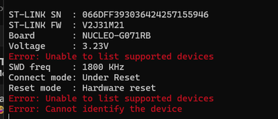

In the way your project is structured, you'll need to put the Data_Base folder at the same level as "STLink_V01_XXX" folder. I also suggest you set the displayCallBacks as done in the main API file to have better logging in case of issues. If that was set you would have had a message like this one:

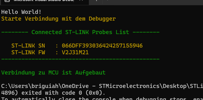

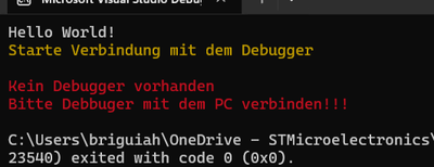

Hi @Mathias89
I'm re-attaching the project to make sure we're in line. I just moved the Data_Base folder:
- Target linked
- No target linked
