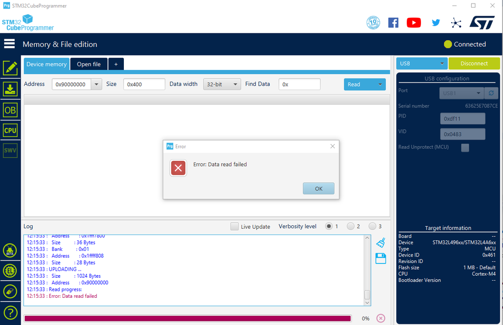

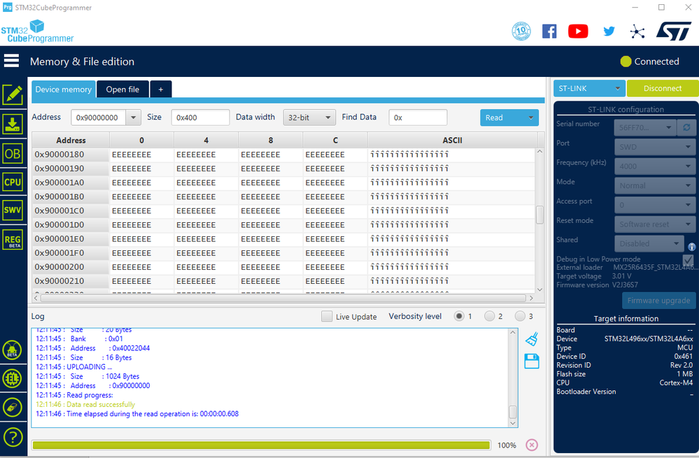

I can use STM32CubeProgrammer to read and write code into external memory via ST-Link. However it fails to access the external memory via the bootloader interface(e.g USB).
Does any one know how to fix the issue?

you mean for programming code into external memory by STM32CubeProgrammer, I have to implement my own DFU? I can program code into internal flash via USB interface. does STM32CubeProgrammer only provide the DFU loader for internal memory?

Thanks Tesla. However, I still don't understand something such as how to configure USBD_DFU_MEDIA Interface, the MCU I am using is STM32L4xx. Does any one have an example for the DFU uploading external memory?
