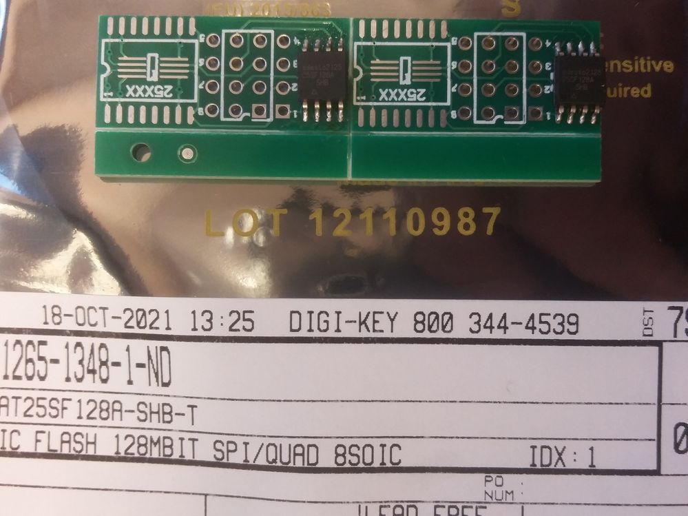

Microcontroller is STM32F746IGT , then I use PB2(CLK), PF8(IO0) , PF9(IO1), PF7(IO2), PF6(IO3) , PB6(CS). I used default STM Loader code. I changed this code for these pins. Now, I make chip erase and sector erase. But, I do not read in memory, show in picture. My read command is "0x6B" .
I have progressed on the subject but could not reach the result.
