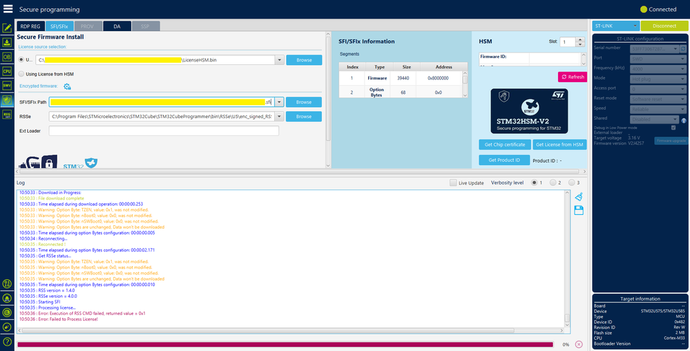

I am trying to install a SFI file on a STM32U575 microcontroller. I have generated the SFI with a binary (0x08000000) and at the time of installing the SFI, I get the following error:
Error: Execution of RSS CMD failed, returned value = 0x1
Error: Failed to Process License!
Why do I get this error? How can I solve it?
Thanks and best regards,
2024-09-12 3:31 AM
Hello @mikel-m
To resolve this issue, please follow the steps provided in this post : Solved: Error when writing secure firmware image to STM32U... - STMicroelectronics Community
