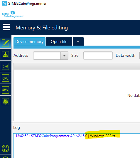

2024-01-14 10:03 PM
I just found the workaround: Install 32bit version of STM32CubeProgrammer.
My laptop and the Windows OS is 64bit, so I normally install the 64bit version of STM32CubeProgrammer.
I don't feel difference using 32bit version. It does the basic job that I need (erase, download to MCU, verify).
