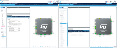

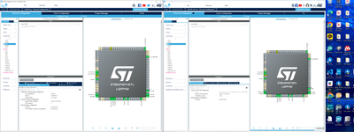

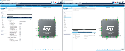

2026-01-29 1:43 AM
Hello
The left is cube.mx 6.4.0 and the right is 6.16.1.
The big difference, as shown in the photo, is that the advanced parameters exist only in the 6.4.0 version in the ETH category, and the platform settings exist only in the 6.16.1 version in the LWIP category.
Please check.
