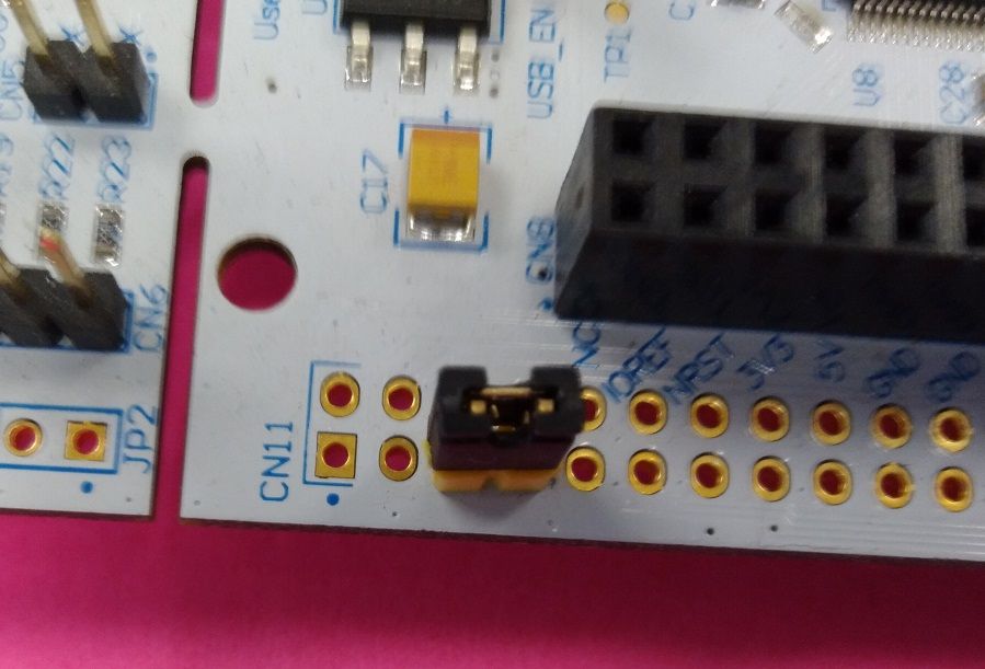

Most likely a SMPS/LDO or VOS setting.
Solder a two pin header between VDD and BOOT0 (BT0) pin, and use one of the spare jumpers parked on the back of the board.
Jumper VDD to BOOT0 connect/disconnect the board a couple of times (cycles power) until STM32 Cube Programmer can see the H7, and then erase the user code off it.

The H7 is an odd bird.
NRST doesn't work as a complete chip level reset, and the device remembers things like LDO and SMPS settings across uses.
Watch very carefully the code you have in SystemClock_Config(), and especially unbounded while() loops. The code might actually be running by dies in a way you can't recover. The BOOT ROM (System Loader) provides a safe-harbour from which to connect from, and to resolve settings issues.
The method described earlier was used in the H747I-DISCO to recover it, there have been several topics about that, and H7's in general. I broken mine early by using H743ZI startup code rather than H747I-DISCO compatible code.
