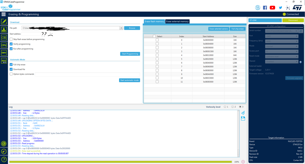

I am interested in flashing specific pages of stm32 chips because im locating some custom binary config files for my application.
I found the option in my stm32cubeprogrammer v2.6.0 to define the Start Address but the data input box cannot be used for some reason?

Check if your file has .bin extension, because it doesn't work with .BIN.

i was saving my config file to .hex, now it works with .bin.
