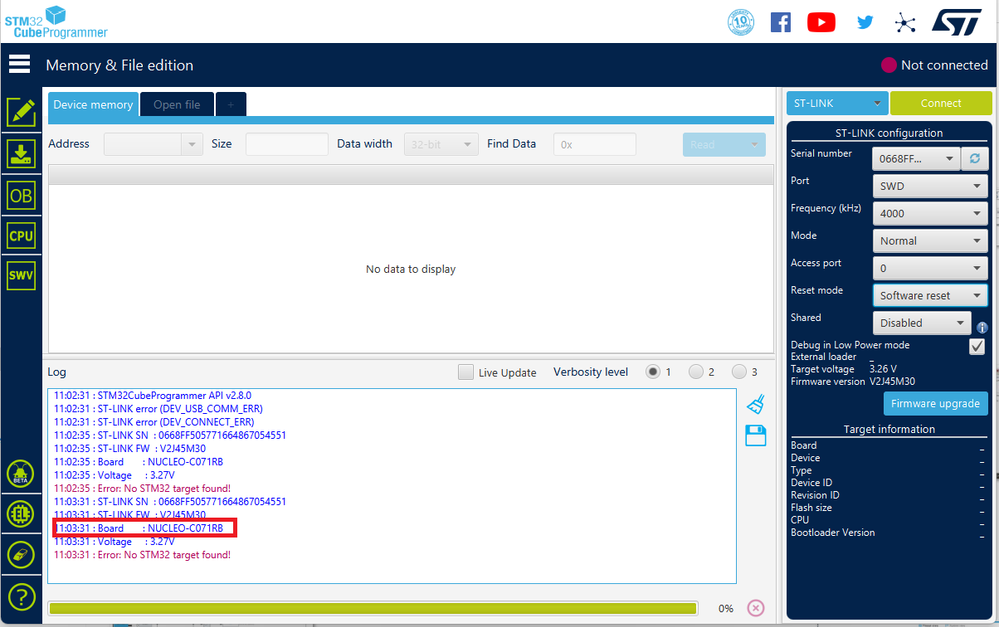

Because now i want bliud my board i tried to connect with the software Programmer with my ST/link2 device (external)

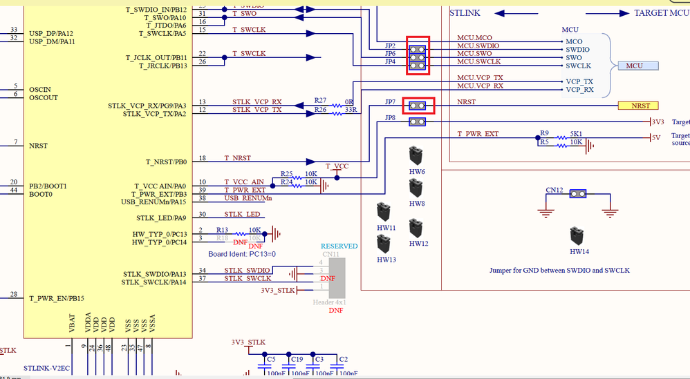

I disconnected JP2-4-6-7 like shown in screenshot.
I power on the board with usb cable.
The Programmer seems recnognize the MCU (NUCLEO-C071RB), but so what does it means "target no found"?

@AndrewFFFF wrote:I power on the board with usb cable.
The on-board ST-Link is still connected to that USB - so the programmer will still see it.
But you have disconnected the target MCU from the on-board ST-Link - so it will say, "No target found"
Instead, you need to connect the programmer to your external ST-Link, and wire that ST-Link to the target MCU.

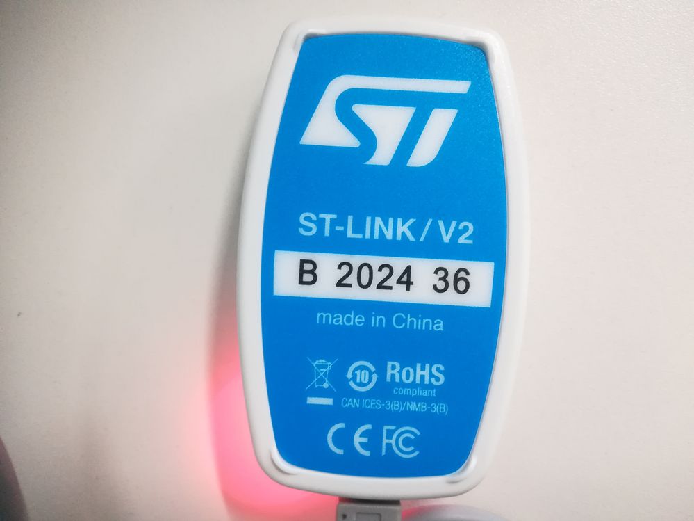

@AndrewFFFF wrote:my ST/link2 device (external)
Is it a genuine ST-Link ?
See: How to recognize a genuine ST-LINK/V2 versus a cloned one
In particular, anything looking like this is fake!

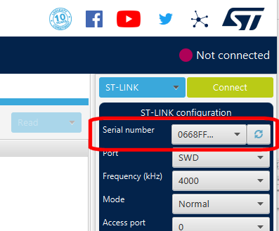

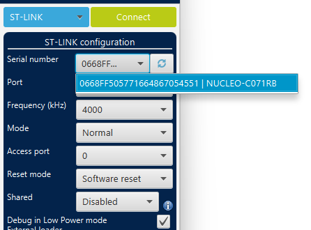

2025-04-02 3:13 AM
Use this drop-down to select which ST-Link to use:

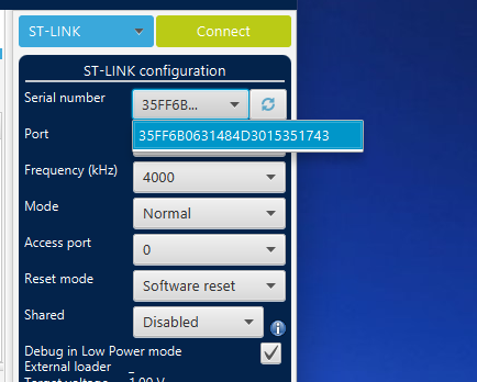

2025-04-02 4:01 AM
Here with the board power on.
Here after the run the software Programmer without power on the board.

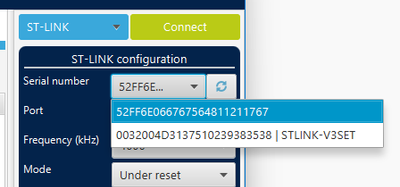

2025-04-02 4:43 AM - edited 2025-04-02 4:44 AM
With both ST-Links connected to the PC, they should both be available in the drop-down list; eg,
You may need to press the 'refresh' button:
Again, is your other ST-link a genuine ST one?
Please show (a) good, clear photograph(s) of your setup
PS:
You have to click the little arrow to get the list:

I connected only SWDIO, SWCLK, NRST, VCC GND
2025-04-02 4:56 AM
so i can connect every jumpers, no conflit?
2025-04-02 4:58 AM
Those are the connections from the Target MCU to the ST-Link.
You also need to connect the ST-Link to the computer - via USB.
2025-04-02 5:03 AM
Here the photo
