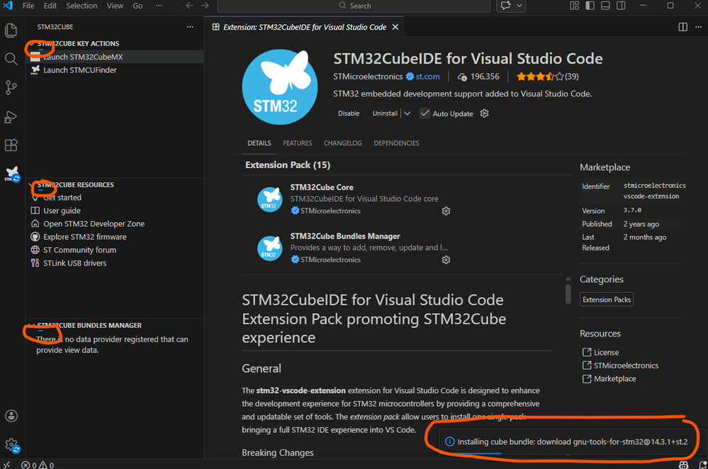

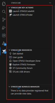

When opening a project directory in VS Code, the STM32CubeIDE for Visual Studio Code extension gets stuck in an infinite loading state (as shown in the screenshot below).
Symptoms:
"Go to Definition" does not work.
The Build Analyzer view does not appear.
clicking the "Build" button still triggers a successful compilation.
Most dependent extensions, such as STM32Cube CMake Support, remain inactive

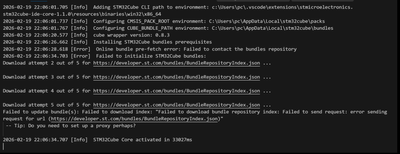

Here is the log output from STM32Cube Core during the failed loading:
I discovered that if I completely disconnect my PC from the internet before launching VS Code, the extension reports a network error but then successfully initializes after a short period. Once initialized offline, all features (including Go to Definition) work perfectly.
Here are the logs from a successful (offline) launch:
My computer’s network connection is working fine. I tested this URL in the VS Code command line —developer.st.com/bundles/BundleRepositoryIndex.json — and it downloads normally. I’ve tried both the latest version (3.7.0) and the older version (3.6.4), but neither fixed the issue. Right now, the only way I can open it is by disconnecting my computer from the network. Is there any way to solve this problem?

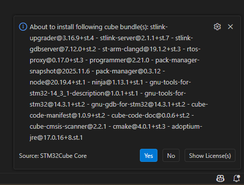

2026-02-19 9:12 AM
If first time install have you seen bottom right notification asking you to accept STM32Cube bundles install as extra of extensions ?

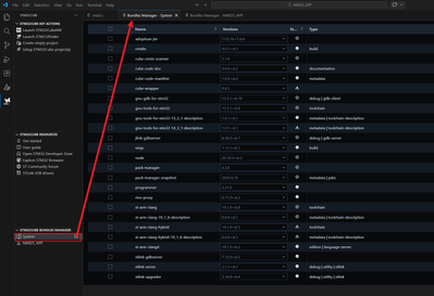

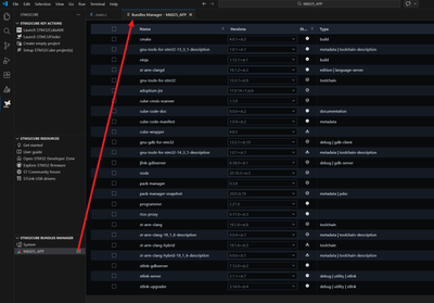

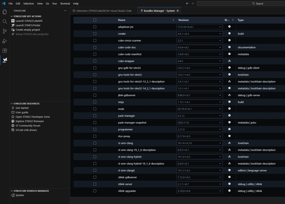

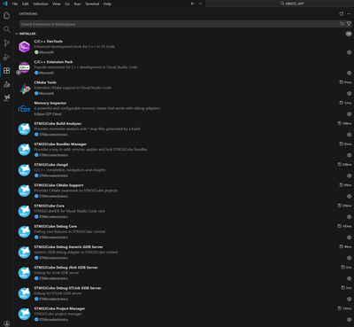

About bundles, they used to download correctly before, so I’m not sure if something is wrong now. How can I verify or reinstall them?
Here is a screenshot of all the extensions currently installed in my VSCode:
I also found a panel called "STM32CUBE BUNDLES MANAGER", and I’ve attached a screenshot of it.

1) Bundles install notification I've accepted
2) Extensions are pending bundles install completion
3) Finally I'm getting hand back and bundle are set ok

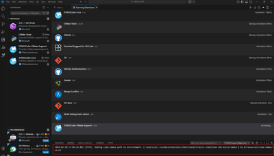

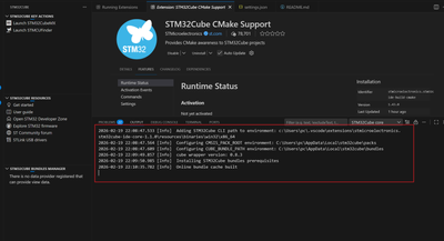

After cleaning my environment, I followed your steps and installed the extensions one by one. However, at step 3, STM32Cube CMake Support got stuck while activating.
I tried restarting VSCode, but STM32Cube CMake Support always stays in the “Activating” state and never finishes.
Below are its logs.
Could this be caused by a network issue on my side?

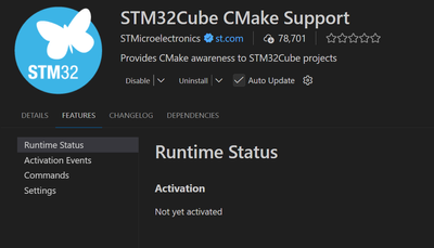

2026-02-20 1:51 AM
Hi @LiHua,
Does "STM32Cube CMake Support" never activate even if you don't have any folder/workspace opened in VSCode ?
