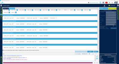

Hi @Aziz BRIGUI ,
Thanks for the reply.
Tried setting WRP1A_STRT, WRP2A_STRT, WRP1B_STRT, WRP2B_STRT to 0xFF and every WRP1A_END, WRP2A_END, WRP1B_END, WRP2B_END to 0x0 and applied, Option bytes programming was successful. (I have attached image for your reference).
But tried to Mass erase the chip which failed with error: ERROR: Mass erase operation failed. Please verify flash protection. (I have attached image for your reference).
RDP is set to AA (Level 0).
Anything else to be done?

Hi @tpate.17
I don't see anything wrong with the OB config now (PCROP addresses shouldn't matter since PCROP is not enabled).
Could you try powering off then on the MCU, connecting via CubeProgrammer, setting RDP to 0xBB and then resetting RDP to 0xAA and retrying the chip erase ?
PS: Please make sure to NOT put RDP to 0xCC otherwise you'll lose your device.

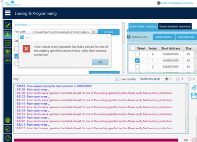

Hi i am using b-l4s5i-iot01a i am unable to Mass Erase the chip i am using latest version of STM32CubeProgrammer and Latest Version of ST-Link
I tried these things
1. WRP1A_STRT, WRP2A_STRT, WRP1B_STRT, WRP2B_STRT to 0xFF and every WRP1A_END, WRP2A_END, WRP1B_END, WRP2B_END to 0x0 and applied,
2. setting RDP to 0xBB and then resetting RDP to 0xAA and retrying the chip erase
3. RDP level we tried to change 0xAA and 0xBB
but still we are unable to mass erase can suggest any other hardware or software method so that i can Erase

Dear @avinpat_8 ,
Can you try to do simple "Pages" Erase, one by one, and all at a time, without Mass erase to see if it works ? and have logs. if successful, it might be a timing issue to investigate.

Hi i have tried by erasing sector wise still unable to erase is there any hardware method to recover this because we have tried all possible case by software
