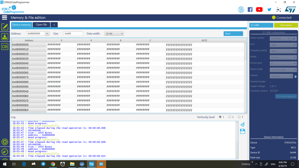

Hi , i want to program a stm32f030f4p6 mcu with st-link but this problem is appeared for me : when i connect to the mcu i can erase chip easily , but when i program it , the content of flash memory not changed , the value of all blocks in flash memory is 0xff ... and i have this error in IAR : Verify error at address 0x08000000 ....., target byte: 0xFF, byte in file: 0x20
.is it a hardware problem and i must change my chip ? if not , what should i do for solving this problem?

I designed the board for myself . programming in boot mode can help me?

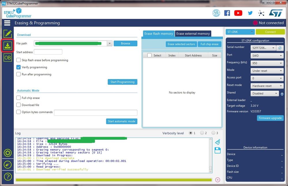

Programming is done via secondary pane in STM32 Cube Programmer

i check my board and the schematic of it, It seems to have no problem in supply and in general in designing , but something that comes to my mind aboat this problem is that : too much hotness of the chip in soldering can hurt it in this way that internal flash memory hurt , but the mcu is identifiable by system? i asked this question because i think , it happened for me :grinning_face: :grinning_face:
