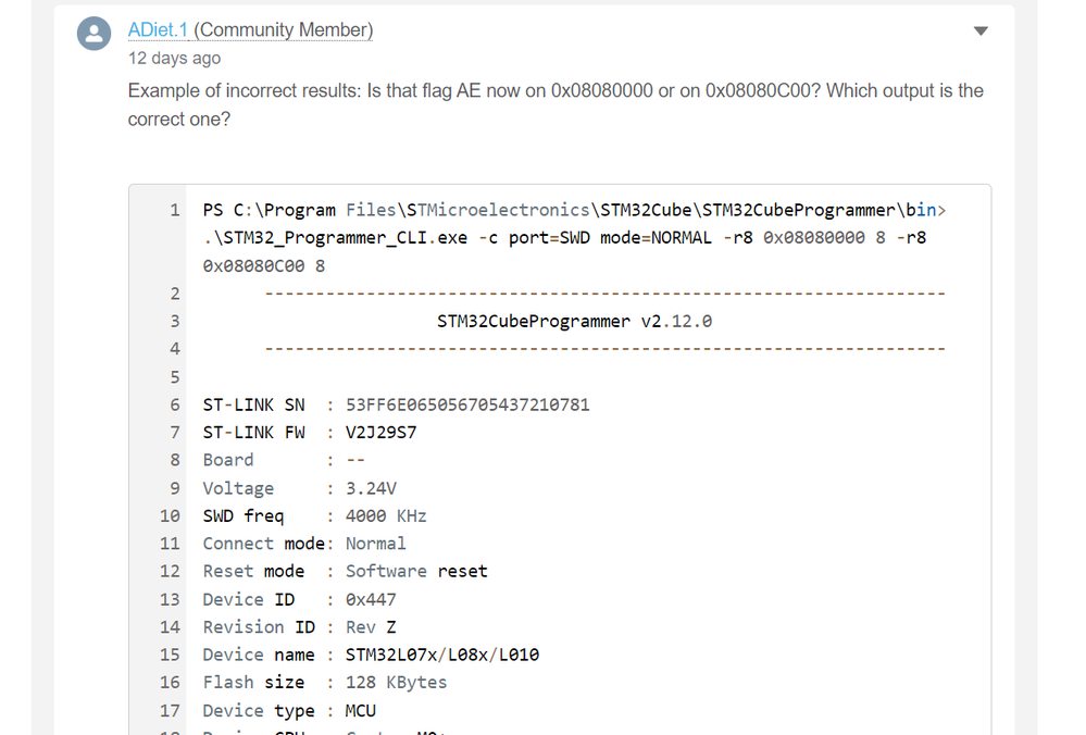

2023-03-22 2:39 AM
I guess the inconsistency is another ticket.
2023-03-22 2:54 AM
Hi @ADiet.1 ,
I mean the issue you talked about here on this post:
Aziz

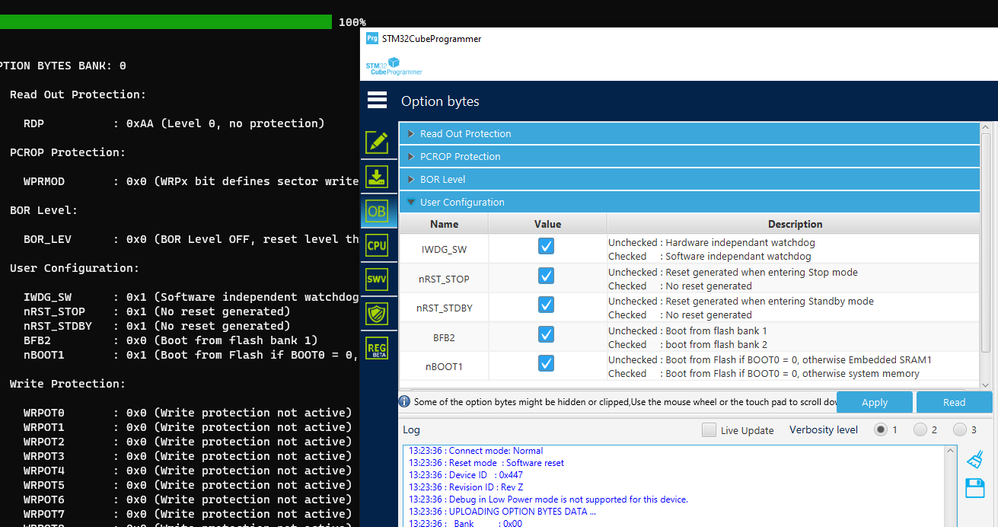

2023-03-22 2:57 AM
Maybe what I mean is the following:
Checking the flag BFB2 on UI and command line gives inconsistent results! I have no idea to know which one is correct!
