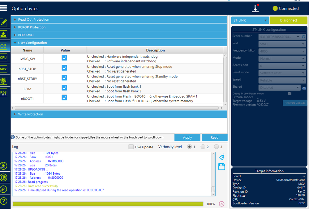

2023-03-21 9:30 AM
Hello, the MCU part number might be STM32L07x/L08xL010 (if not please provide the way to get this number). I am not sure I can share the binary file, but the option byte configuration is as follows:
