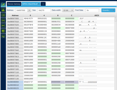

I've discovered an interesting quirk. When trying to load the elf file with the headers shown below, STM32CubeProgrammer erases the 2kB internal flash page on the STM32G474RE (dual bank mode) at 0x08007000. It then programs in the ELF file header. This sort of makes sense; there is a "hardware information" flash page at 0x08007800. However, it is set to NOLOAD in the linker script, and so there isn't actually any data there. In general, STM32CubeProgrammer does a good job not flashing areas which are NOLOAD, but for whatever reason it decides it simply must have something at 0x08007000 in this case. In fact, if I open the .elf in STM32CubeProg, there is data loaded in the viewer. However, using objcopy to create a binary, ihex, or srec file does not emit this area (rightfully so).
We can work around this issue by using .ihex instead (within STM32CubeIDE GDB sends it down to the STM32G474RE as a temporary .srec) but ideally I should just be able to use the .elf.

Hello @pmwpcs,
STM32CubeProgrammer will download any "LOAD" type program in the Program Headers. Seeing the program headers you shared, it seems there's a load segment at 0x08007000 which points to the start of the elf binary file:
Aziz
