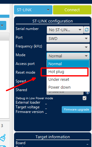

2023-03-10 4:12 AM
This
should result in debugger connecting without reset. There should be a counterpart to this in the CLI too.

2023-03-10 4:15 AM
I tried that, but when I use the mode HOTPLUG I get incorrect results! The application returns bytes that are incorrect!!
2023-03-10 4:18 AM
I asked for 8 bytes at two different addresses and when using HOTPLUG I got the results swapped (checked with GUI application). now it seems to be working. I have the feeling I cannot rely on these tools. What can I do?
