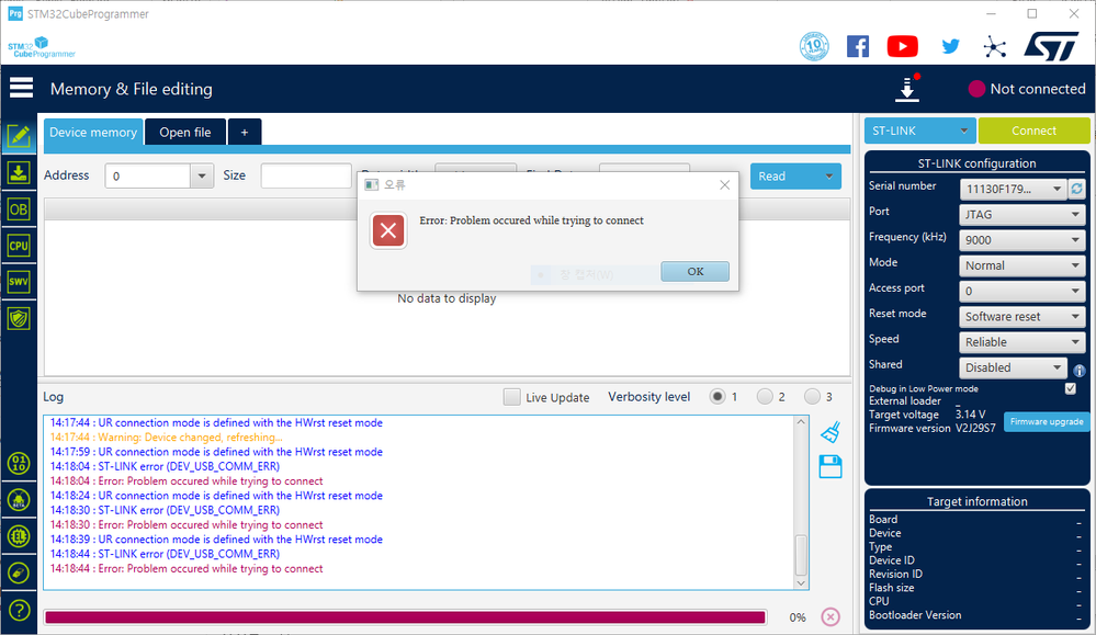

l want to connect pcb board through stm32cubeprogrammer.
But it posts pop-up like that.
The error massage is "Error: Problem occured while trying to connect".
And sometimes it connects well, so i can't find the reason.
Could you give me some adivce to this problem?

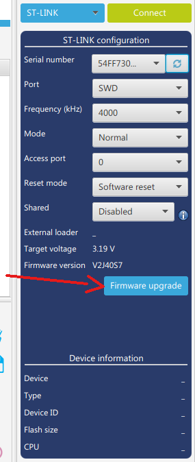

you have old firmware, V29 ; now is V40 ...about.

I've already downloaded the latest version from this site, and I've checked the jtag connection. And sometimes they connect well. If i try 100 times, it will be connected about 1 time, and in that state, the connection will be good until the computer is turned off.
2023-05-14 11:56 PM
oh it connects well. I really appreciate your hep. Thanks a lot!!
