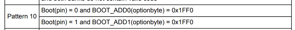

If realy all your bridges transfer parity to MCU pins , then only one next condition
_legacyfs_online_stmicro_images_0693W00000bk1vmQAA.pngrequred is add1 set properly.

On powerup the "BOOT0" (pin 197) is tied to VDD that is 3.3V ~ "1".
what is the next step to check?
