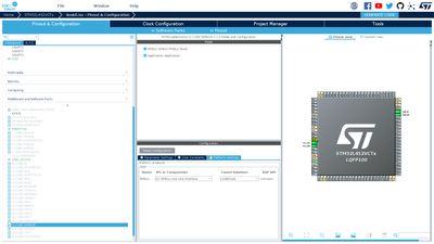

Hello @ACipr.1
I used the latest version of CubeMX 6.10.0 to check the issue mentioned above and this is what I got please have a look :
Thx
Ghofrane

2023-12-04 6:30 AM
Updating CubeMX resolved the issue. Thank you
