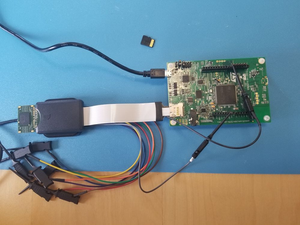

Capacity seems all wrong for a 4GB eMMC, and I'm not sure I've coded to manage anything below 2GB
The ODROID cards with their MicroSD adapter connect more directly into the STM32 DISCO/EVAL boards.

Blank eMMC devices will need to be formatted. If you've validated the READ, and then WRITE functionality, you're ready to use f_mkfs()
I found these ODROID cards to be less of a circus
https://www.hardkernel.com/shop/8gb-emmc-module-c2-android/
2019-04-02 3:38 PM
STM32F413H-DISCO eMMC test code, blind port, I don't own this board.
Outputs via VCP at 115200 8N1, at first prompt hit ENTER, will prompt to format if necessary.
