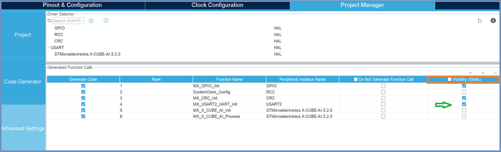

In fact, you can change the Functions Visibility directly through CubeMX and according to your need, you can find this option under Project Manager- Advanced Settings as mentioned in the image below:
Hope my answer helped you, when your question is answered please close this topic by choosing Select as Best, this will help other users find that answer faster.

2021-03-08 3:38 AM
Hi, thanks for your answer.
This is indeed the proper way to solve this problem.
However, in a previous version (it may have been STM32CubeIDE 1.2.0 and X-CUBE-AI 5.0.0, not sure), I did not encounter this problem to begin with. After creating a fresh project and adding the Validation template of X-CUBE-AI, the project could be built immediately without changing the MX_USART2_UART_Init() function visibility.
I think the visibility should be automatically changed when adding the Validation template of the X-CUBE-AI package.
Thanks,
2021-03-08 5:59 AM
Hi again @piernov
Actually, when the function is generated as static, it will be initialized only in main.c, in case when it's generated as non-static, it will be defined also under main.h, so that the problem will not appear.
Could you please check with the latest CubeMX/IDE versions (6.2.0 and 1.6.0)?
