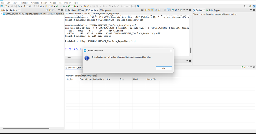

I'm having an issue with a pre-existing project. It was initially built a few months ago on version 1.16 of the IDE, and confirmed to be working. I have since updated to stm32cube ide version 2.1, and am having an issue with this project not being able to launch.
The projects builds with zero warnings or errors as expected, but on trying to flash my board I get "Unable to launch. the selection cannot be launched, and there are no recent launches".
One change I made (that I'm not sure if it is relevant) is updating the GCC flags to inlcude "-Wno-implicit-function-declaration", as it was having trouble finding a C wrapped extern method.

Usually this happens when a project is not imported correctly. You could try removing the project from the workspace and double clicking the ".project" file to open it. A full screenshot of the IDE may also help.

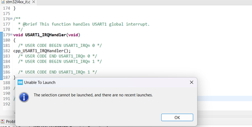

2026-03-15 10:44 AM
Thanks for the reply. I've removed the project and reimported it by clicking the ".project" file. Still having the same issue:
2026-03-15 11:25 AM
I was able to solve this by opening run -> run configurations, and applying a new configuration
