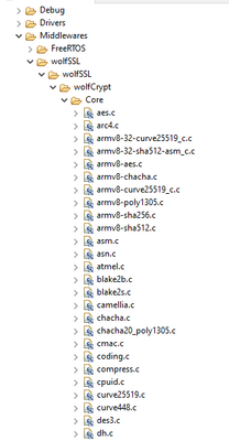

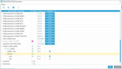

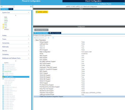

If you want all .C files to be generated, I suggest you to use an updated firmware. Than and using CubeMX, choose your board. Configure the freertos and then, configure the WolfSSL like that:

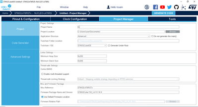

After that and before generating your project, disable the generate under roots option

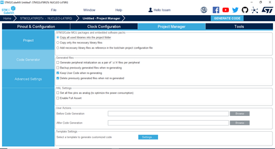

Then in the code generator choose the option copie all used libraries into the project folder as shown below:

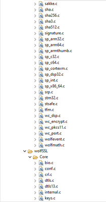

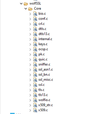

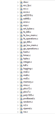

Now generate your project and you will find all .c files:

I looked back on my settings in CubeMX based on your images above, and I didn't have the WolfCrypt Core selected. I just had the wolfSSL / Core selected. Thanks for the quick resolution.
