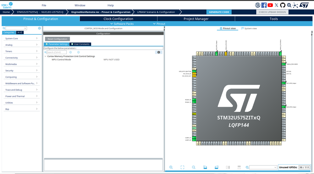

I'm experiencing complete failure in generation of new projects. Using either CubeMX or CubeIDE it is the same behavior.

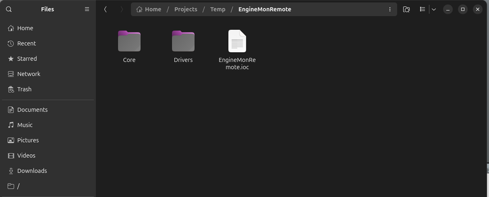

Generate a new project like I've done for 10+ years, only to find the folder structure missing almost everything required to build a project.
Standard structure:
This is selecting STM32CubeIDE as the Toolchain / IDE

Seems to be the same behavior for multiple MCUs as well.
I don't see any error messages. I've reinstalled the STM32CubeMX application and refreshed all the packages.

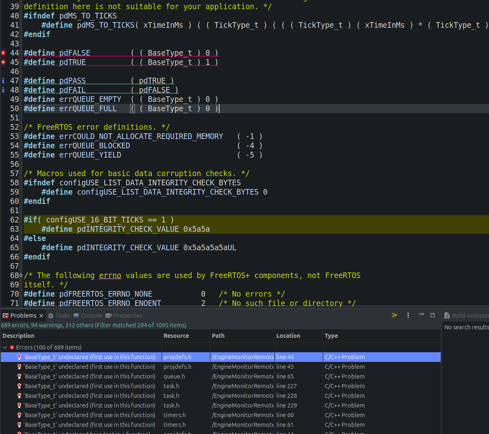

Maybe not related, my older projects, when migrating to the latest version, 6.13, now will not build. Errors in missing definitions for FreeRTOS. BaseType_t is undefined.

I've solved it. The latest cube packages are missing the FreeRTOS portable/GCC files, port.c and portmacro.h.
I copied the previous versions portable directory to the latest and it now works correctly.
