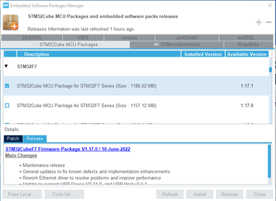

I've reproduced your issue using CubeMX 6.9.1 and it seems to be working fine (CubeF7 1.17.1 exist in the embedded software packages manager)

I can confirm that issue after installing the last update (v1.17.1) it looks like the version that has been installed is the 1.17.0 version.

I've just discovered that after installing the 1.17.1 and the version that has bin installed was 1.17.0. CubeMX proposed a new patch in the "manage software installation" wher I've found a 42MO patch that I've downloaded and installed and it works fine now. @Bob S I suggest you to download the 1.17.0 version and than download and install the patch proposed as update from CubeMX.
Best regards.
