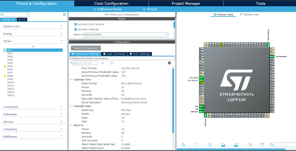

2021-10-19 7:52 AM
Thanks for the answer, I looked at the example but did not find solutions!
I thought if I will activate the interrupt for alarm of RTC and in the code to call the desired Callback, then the alarm clock will work ... But, not in my case and I do not understand why it is don work!
I will give any information. I just don't know what exactly you need to show.

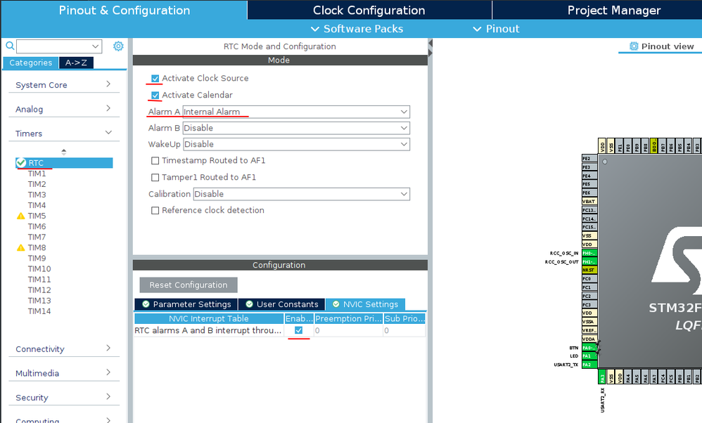

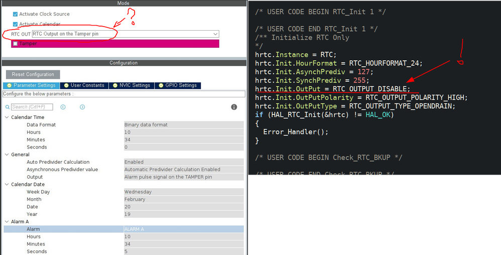

2021-10-19 8:56 AM
I think the reason why my alarm clock do not work, it is because, I do not have some setting!?!? see screenshot.
And so I have "RTC_OUTPUT_DISABLE" in my the code.
If I'm right, how to fix it is?

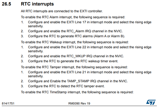

2021-10-19 10:08 AM
Have you connected the EXTI line 17 to the RTC Alarm event ?
Did you set the following sequence correctly? (to enable the RTC Alarm interrupt)
2021-10-19 10:56 AM
No, and I do not know how to do it!
