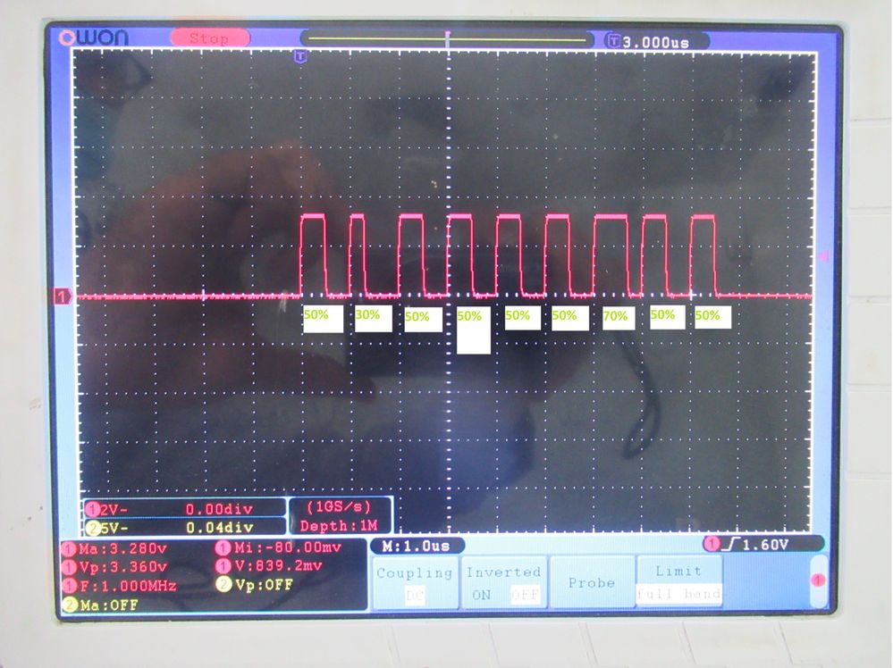

I generate 7 pulses with frequency 1Mhz and duty cycle of pulses is 50,30,50,50,70,50,0% sequence.
But the result have some issue:
I don't understand why !
>>> Signal on my OSC:

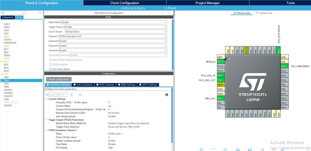

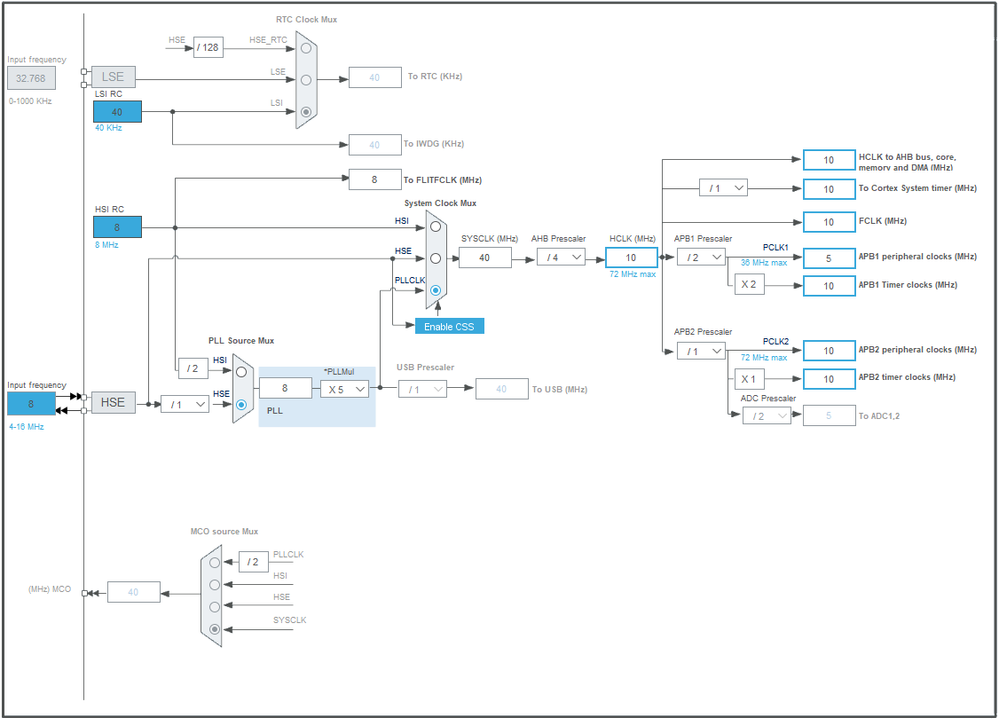

Sys clock=40Mhz, Timers clock=10Mhz
PWM config

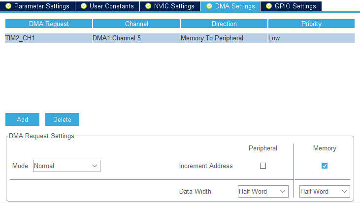

DMA config

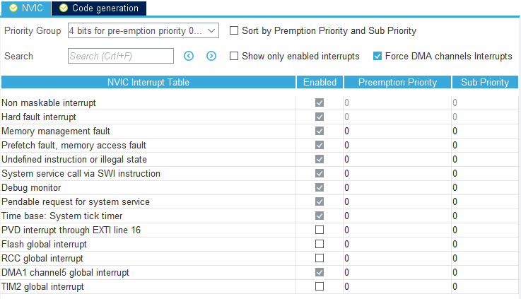

NVIC by default

IMO this is simply DMA not succeeding to fill the new value to CCRx in timely manner. Try increasing system clock frequency, or set APB divider to 1, or both.
2021-10-19 8:11 PM
Hi JW, thank you for your reply.
Could you show me the documents or application note talk about "DMA not succeeding to fill the new value to CCRx in timely manner" ?
I want to learn more.
BR!
2021-10-19 11:13 PM
Read AN2548.
