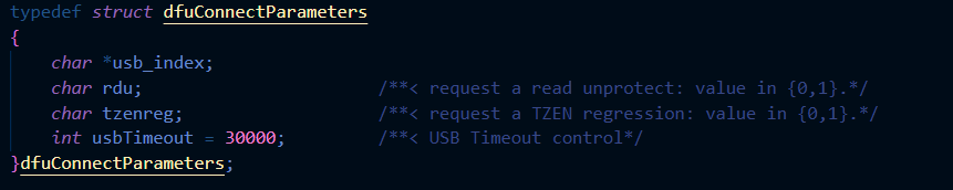

The connection error -16 indicates that RDP is enabled. You can set RDU to 1 to change RDP from Level 1 to Level 0.
You can also find more about the error codes in the CubeProgrammer_API.h file.
