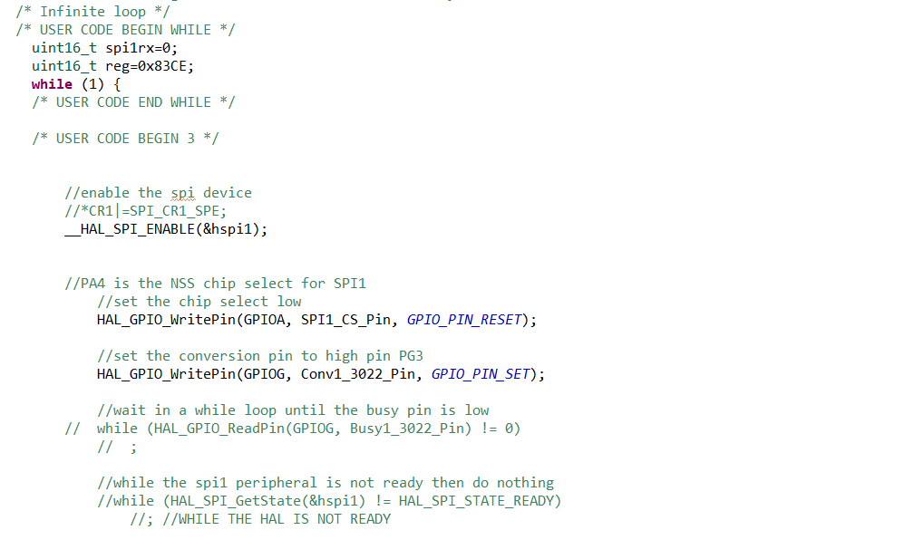

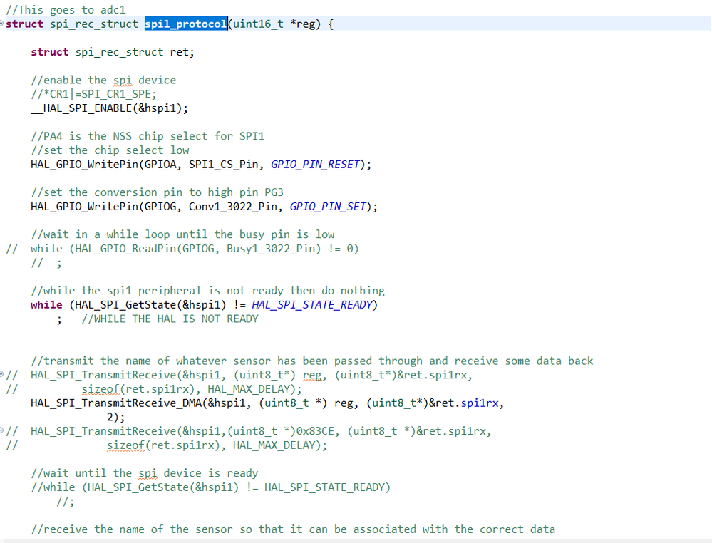

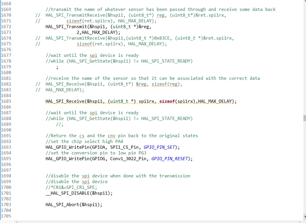

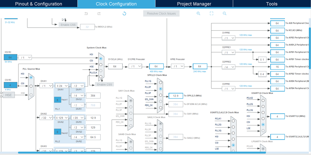

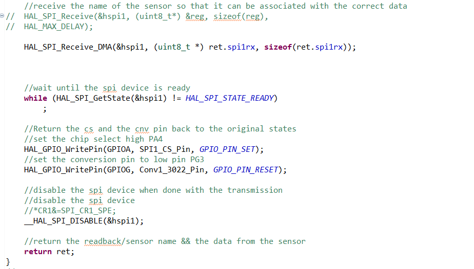

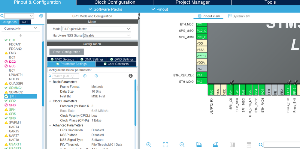

Hello, I am running into an issue using the SPI functionality on my STM32H7 chip that is on a custom made board. What I am trying to do is read an adas3022 adc (Link to datasheet below) on a spi peripheral from the STM32H7. I have written functions for the spi protocol that are run in some tasks using freeRTOS. However, even outside of the task, just inside of the main while loop, it seems to not show the pulse of the clock. The gpio pins are shown to be correct (high and low) but the clock pin is not showing anything on the oscilloscope at all. The code also gets stuck on the second loop around waiting for the spi peripheral to get ready but it never does. There is a workaround suggested in the following forum and manual that I have read but it doesn’t seem to work. Below are screenshots of the main code and links to the manual and forum:
Figure1: part 1 of my spi_protocol() function.
Figure2: part 2 of my spi protocol function.
Figure 3: part 1 of my main while loop with the enable and workaround shown.
Figure 4: part 2 of the main while loop with disable and abort used for testing the spi and trying to get it unstuck.
Figure 5: the spi configuration that has been set up.
Figure 6: the clock configuration that has been set up.

Do you call HAL_SPI_Init somewhere?
I would get it working without DMA first, then add that part later on. It doesn't look like you're waiting for the DMA transaction to finish before starting the next one. Monitor the return value from HAL functions and do something useful when it's not HAL_OK such as logging the error to a UART stream so you can debug it properly.
2021-10-19 7:44 AM
