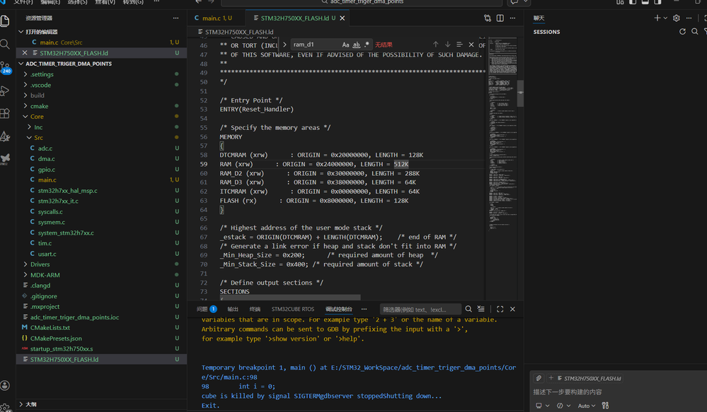

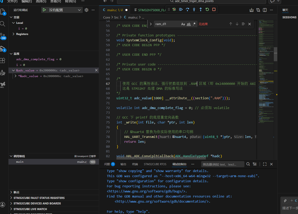

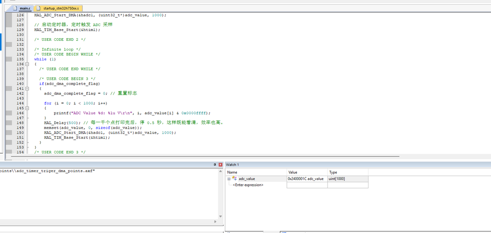

When I was using Keil and VSCode with the same piece of code, I found that I couldn't enter the ADC_DMA interrupt callback function when using VSCode. I was looking up the information and debugging in two software programs. I found that the address of the array where I stored the data was 0x20 in VSCode, while it was 0x24 in Keil. I attempted to adjust the array address to the correct one, but found that it couldn't be adjusted properly.If there is a solution, please let me know. Thank you.

In the GNU linker script you should properly define a filter for section named ".RAM" in the link script (look at examples or ask your favorite AI). Or, move the DTCMRAM to the end of regions (anywhere below the RAM region).
