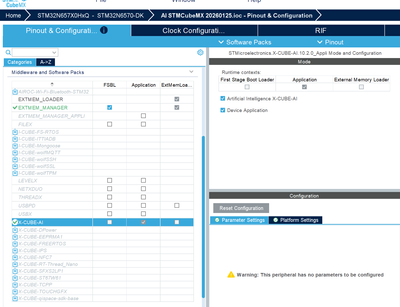

Hi, I'm developing a project for STM32N657X0HxQ MCU and I need to run a NN model on it. I installed the 10.2.0 package for X-CUBE-AI and I've selected Core for Artificial Intelligence X-CUBE-AI in the Software Packs component selector. However, whatever Device Application I select, I always get when I'm on the Configuration Tab in Pinout & Configuration "Warning: This peripheral has no parameters to be configured" and I cannot upload my NN model, even when Artificial Intelligence X-CUCE-AI checkbox has been selected.
I'm using the 6.16.1 Version of STM32CubeMX.

2026-02-02 2:44 AM
This .ioc file I show you with a screen shot was established by following the guideline of "How to build an AI application from scratch on the STM32N6570-DK using STM32CubeMX".
BTW,I consider that the warning about "this peripheral has no parameters to be configured" may depend on the device rather than the file...Because I got everything normal in my Desktop, while warning took place in my Laptop,even within the same .ioc file.

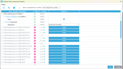

2026-02-02 3:12 AM
Hello @linreedus
By checking the "How to build an AI application from scratch on the... - STMicroelectronics Community"
You are using "Application Template" as the application type.
I retest again using a Laptop and it's working just fine.
THX
Ghofrane
