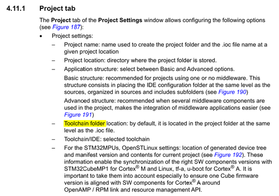

I have tried to understand what this is by consulting the User Manual UM1718 Revision 49, and there were two references that matched the text "toolchain folder", both of which provided no helpful guidance on what this is actually used for.
This is pretty much the only reference that describes what this option is for, which basically tells you nothing but confirms the toolchain is located in the project folder by default.

“Toolchain Folder Location” does not point to your compiler installation (e.g., GCC ARM). Instead, it is simply the directory where CubeMX generates the toolchain/IDE-specific project files.
It is not used to locate arm-none-eabi-gcc or any other compiler binary.
It is the output folder for generated build-system artefacts, depending on the chosen “Toolchain/IDE”:
