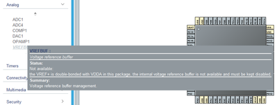

I'm not using my PC now (so i can't open the .ioc file). But if you want to know way this option is geayed and you can't use it, you may have to put your cursor on the option you want to enable under mode tab and a pop up will apper with a full description of why this option is geayed and what to do to enable it.

Thank you for the info! I have done that already, below is a screenshot regarding that. But it still makes me wonder why, since the same chipset doesn't have the VREF+ double bonded with VDDA in this package. Even so, I genuinely don't know what to do with the VREF+/VDDA.

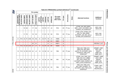

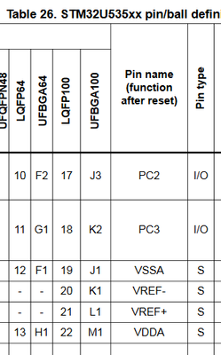

In 'U535, the VREF+ pin - consequently VREFBUF - is available only in the 100-pin packages:
