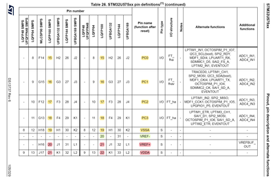

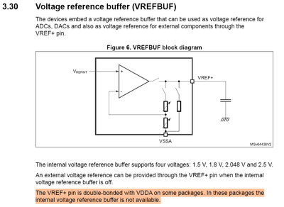

2025-02-06 2:31 AM
The reference manual states that VREF+ is not available for some packages and is double-bonded with VDDA.
However, the package I am using should not be affected by this (after all, it already worked with the old software version).
Could it be that there is a bug in the CubeMX software that it assumes that VREF and VDD are double-bonded in my package as well?
