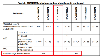

2025-04-16 4:28 AM - edited 2025-05-09 1:34 AM
Indeed and according to the datasheet:
A ticket will be escalated internally (internal ticket number 207882). Thank you for your contribution.
