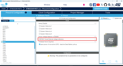

I am using STMCubeIDE with cubeMX, in that there is no such configuration for VREFBUF. is there any alternative way for that?
2026-01-23 1:49 AM
After checking, VREFBUF option is available under SYS menu.

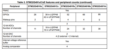

According to the datasheet STM32G491RET6 features an internal voltage reference buffer (VREFBUF)
It seems VREFBUF option is missing in CubeMx. I will escalate internally for analysis and eventual fix in the tool (internal ticket number 225569 for follow-up).

2026-01-23 1:49 AM
