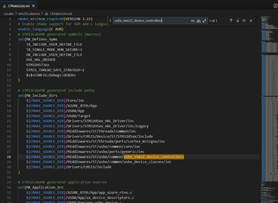

Hi @Quazar
Would you attach IOC file to replicate.
As far as I can see,
${CMAKE_SOURCE_DIR}/Middlewares/ST/usbx/common/usbx_stm32_device_controllers
usbx_stm32_device_controllers is already included.

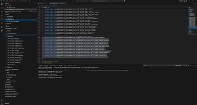

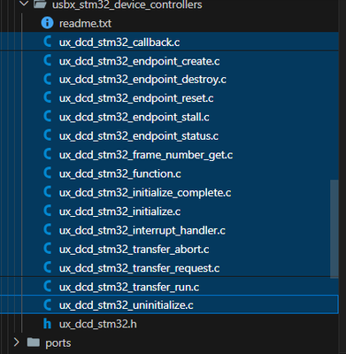

Missing files in cmake/stm32cubemx/CMakeFiles.txt.
In project.zip i added a cleanly generated project using the exact same ioc i have in my project. No .c files under this folder are included in the project.

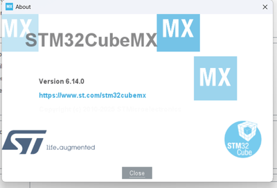

I am using STM32CubeMx version 6.14.0. on windows 11
Steps:
1. coppied ioc to new folder
2. opened ioc with cubemx
3. generated clean cmake project
4. imported project to vscode
5. build project - success
6. added `ux_dcd_stm32_initialize(0, 0);` in USBX/App/app_usbx_device.c:MX_USBX_Device_Init()
7. build project - fail
8. added *.c files to sources in ./CMakelists.txt
9. build project - success

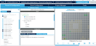

Hello @MR5
After checking the provided project https://github.com/mrubli/stm32u5-usbx-cmake-test
You did not select the device controller HS. As a result, MX did not generate the file in the CMakeLists.txt.
If you need to use the file, navigate to /Middlewares/ST/usbx/common/usbx_stm32_device_controllers. You need to select usbx -> ux Device HS -> Device Controllers "
THX
