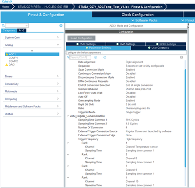

I am currently working with the STM32G071 microcontroller and encountering an issue with the ADC when using a specific configuration.
Here is a summary of my setup:
ADC configured in "Sequencer fully configurable" mode
Scan conversion mode: Disabled
Discontinuous conversion mode: Enabled
Oversampling: Enabled (Ratio = 8x, Right bit shift = 3)
When I measure two or more channels in this setup, the last channel in the sequence shows an incorrect result, with an error of about 30%. The earlier channels in the sequence seem to be accurate.
I would like to understand if this behavior is expected due to the chosen configuration, or if there is a workaround or recommendation to avoid this issue. Any guidance or clarification would be greatly appreciated.

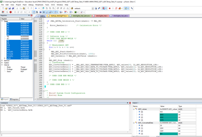

2025-05-22 4:55 AM
First of all, my measurements work perfectly without oversampling or in "not fully configurable" mode.
I'm having an issue with the last measurement when I choose the "fully configurable" mode with oversampling.
I’m attaching the .ioc file and my main.c
Thank you for your help.
