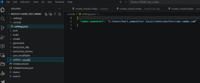

I checked the path and it was set for "cmake" instead of "cube-cmake", so updated it.
When building the project i got different errors
[cmakeExecutable] CMake executable not found in cache. Checking again.
[proc] Executing command: cube-cmake --version
[proc] The command: cube-cmake --version failed with error: Error: spawn cube-cmake ENOENT
[proc] Executing command: cube-cmake -E capabilities
[proc] The command: cube-cmake -E capabilities failed with error: Error: spawn cube-cmake ENOENT
[main] Building folder: Nucleo-C562RE_Test_cmake
[rollbar] Unhandled exception: Unhandled Promise rejection: build Error: Build failed: Unable to configure the project {}I had the VS Code agent fix it. It added a wrapper "cube-cmake.cmd" which created this text
@Echo off
"%~dp0cube.exe" cmake %*But it still had the same build error. Then I had the agent try to fix again and it create a settings.json file and added a path.
So now I am able to build the project with zero errors.

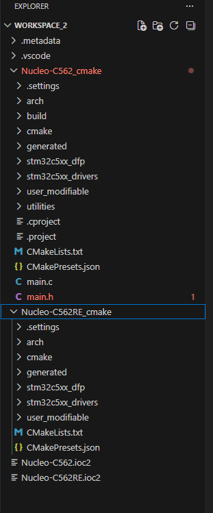

I started a board project in CubeMX2, then it generated the IOC2 file. It then asked if i wanted to open the project, which i did. In the GUI, i enabled some peripherals and the System Tick. Then i had it generate the cmake project. But the main.c/h and files were missing.

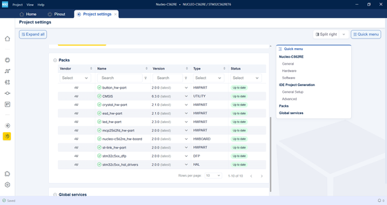

It looks like main.c/h are missing because the pack 'stm32cubemx2_templates_no_os_stm32c5' is not installed in the Pack Manager.
and in the attached project, I didn't see the 'stm32cubemx2_templates_no_os_stm32c5' pack which is responsible of generating those files and the startup component.
It contains only 10 packs while a project created from board contains 12 packs.
we need to check whether the template pack is already installed 'up to date" in Pack Manager.
Could you please open pack manager and share a screenshot of the "Up To date" packs?

Yes, I looked at the project and only 10 packs are there for that project.
The 1st project i created has 12 packs. That project had errors building in VS Code. I had VS code fix it so it would build. I can't remember what it did.
