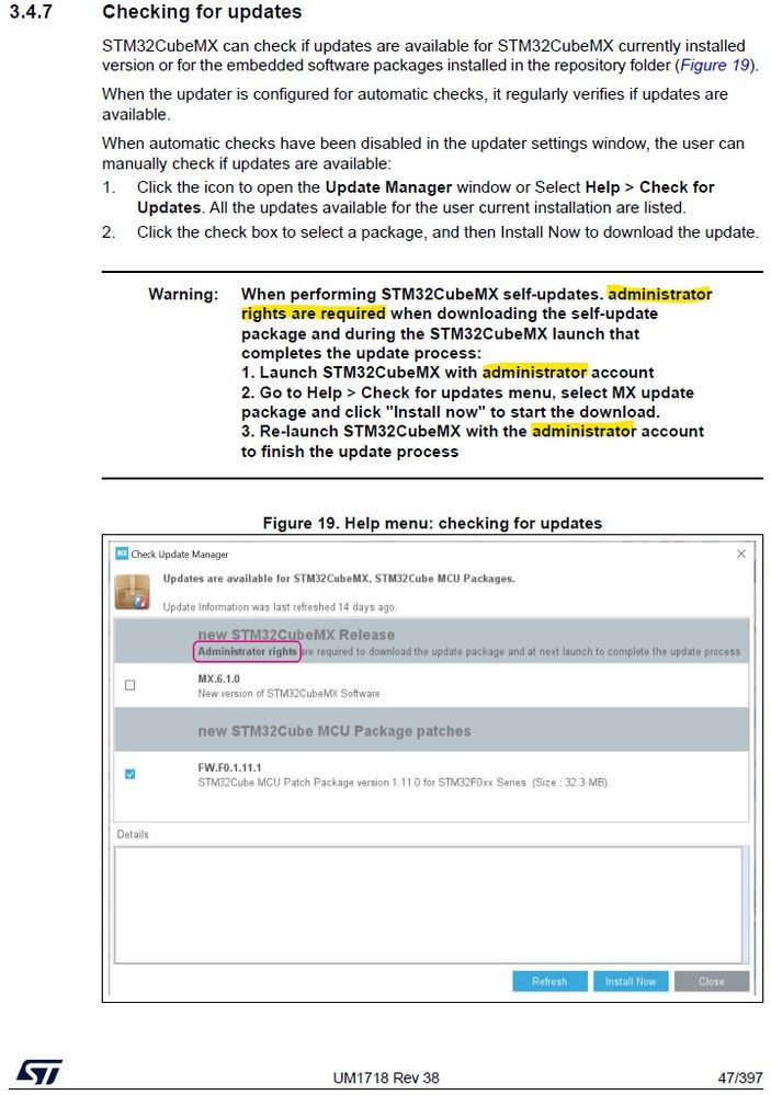

Hi @Bob S ,
Can you please refers to the CubeMX User Manual UM1718.pdf or follow these instruction [Extracted from CubeMX UM]:
Main attention:
1- You need to start CubeMX as Admin (right mouse click > 'Run as administrator')
2- Perform the CubeMX upgrade
3- Close CubeMX
4- Re-start again the CubeMX as Admin to finish the upgrade process
Regards,
Aymen.

Hi @Bob S ,
Main attention:
3- Close CubeMX
Regards,
Aymen.
