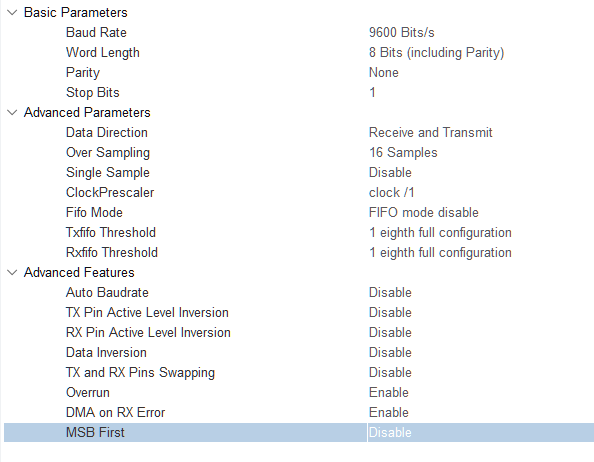

i have problem for using STM32H743VI. start from the basic problem, that is transmit UART standard. i use latest firmware of STM32H7 version 1.5.0, latest update STM32CUBEIDE 1.1.0 and latest update STM32CUBEMX 5.3.
here the code:

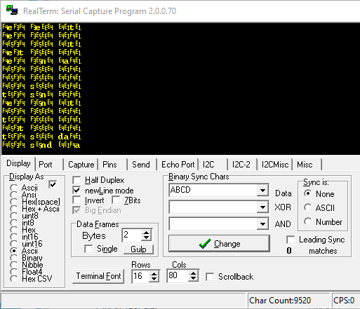

the output is showed by image that i attach here. please any help?

Timing looks close.
Hows this all connected from STM32 to PC?
The STM32 doesn't output RS232 compatible voltages, needs MAX3232 or similar to do voltage conversion/inversion.

I had uart trouble with an f7 after switching from hsi to hse oscillators. Turns out hal was not calculating the baud rate correctly, so i just wrote my own initialization routine with the correct baud rate hard coded. I don't trust hal.

Thanks guys for the answer..
i got the problem. First, yes timing/clock problem. So, i switch manually from HSI to HSE for clock source. little bit tricky, but nice learn. Thank you.
