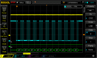

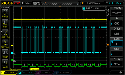

Working! What i did?
In all tests below, I was sending 'A' (0x41) at 115,200
Sending 8N1 - everything works fine:
Sending 8E1 - NOT working:
Data is indeed corrupted.
I changed the Scope settings to None and the data was parsed in the scope OK

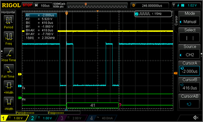

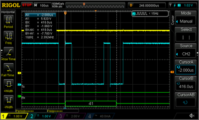

So I sent only 1 byte:
Sending 1E8
Both regular sending & DMA received wrong - Parity is missing!
So I changed data length to 9bits - It's working!

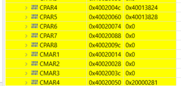

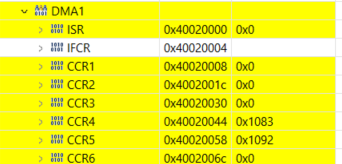

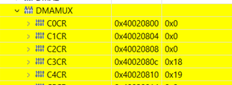

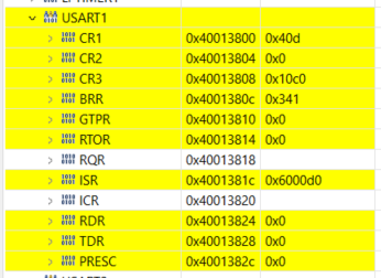

2025-10-21 6:22 AM - edited 2025-10-21 6:30 AM
Registers value, after config, before sending/receiving anything at all.
USART1:
DMAMUX:
All other regs under DMAMUX are 0x0.
DMA1:
All other regs under DMA1 are 0x0.
CMAR4 is indeed the address of my rx_buffer.

2025-10-21 8:31 AM
Registers look good at this point, as well as the Tx code.
You may want to have a look at them and compare after UartSend.

2025-10-22 3:51 AM - edited 2025-10-22 3:54 AM
Sending 1E8
2025-10-23 9:07 AM - edited 2025-10-23 9:08 AM
In the STM32 UART, contrary to the usual convention, parity bit counts towards the total bit number.
In other words, for 8E1, you need to set 9 bits in the STM32 UART.
And yes, I have forgotten about this, too...
