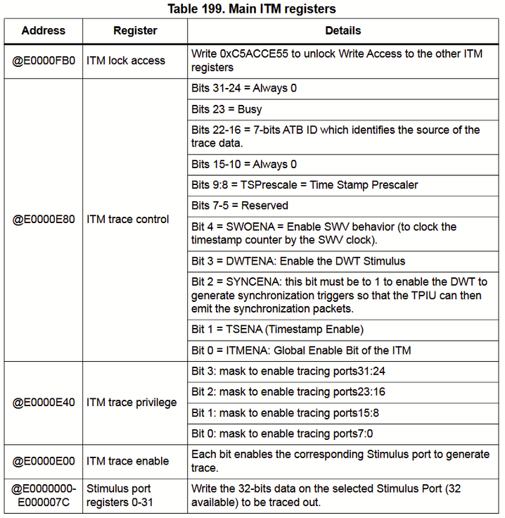

I'm attempting to follow https://community.st.com/t5/stm32-mcus/using-the-itm-console-for-printf-redirects-and-lwip-debug/tac-p/850072/highlight/true#M1661 but this always fails. This is on an STM32F303K8T. My reference manual says
and offers an example:
"To output a simple value to the TPIU:
• Configure the TPIU and assign TRACE I/Os by configuring the DBGMCU_CR (refer to
Section 33.17.2: TRACE pin assignment and Section 33.16.3: Debug MCU
configuration register)
• Write 0xC5ACCE55 to the ITM Lock Access Register to unlock the write access to the
ITM registers
• Write 0x00010005 to the ITM Trace Control Register to enable the ITM with Sync
enabled and an ATB ID different from 0x00
• Write 0x1 to the ITM Trace Enable Register to enable the Stimulus Port 0
• Write 0x1 to the ITM Trace Privilege Register to unmask stimulus ports 7:0
• Write the value to output in the Stimulus Port Register 0: this can be done by software
(using a printf function)"

but this always hangs on the NOP loop. I've also tried changing the ITM_TCR_TraceBusID and enabling SYNC, to no avail.
What could be happening here?
2026-01-22 10:57 AM
Right after posting this, I found that STCube's SWV ITM Data Console needed to have Start Trace enabled for the loop to unblock, which I guess is what is implied by the SYNC feature. That's fine for debugging I guess, but this seems like a non-starter for production when the debugger is not connected.
