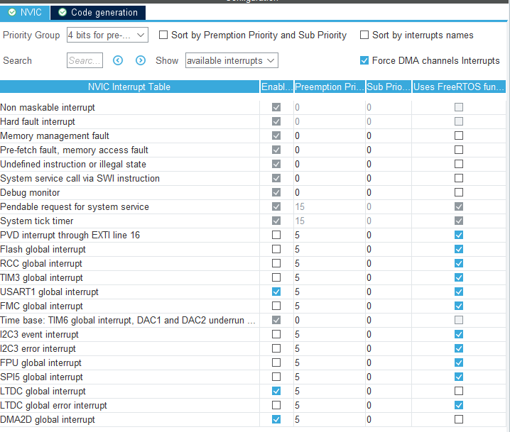

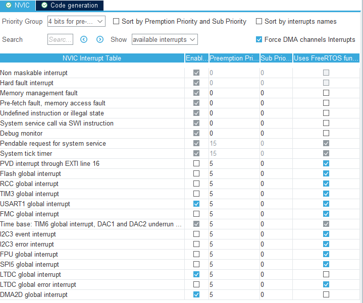

Hi, another annoying thing in CubeIDE is if the FreeRTOS is in use, and user is enabling DAC, interupt for TIM6 changes priority from 0 (default in new project) to 5 due to settings in FreeRTOS section, causing the system not to start. FreeRTOS only allows priorities 1-15, default 5, so without moving system timebase to another timer, one is stuck with bricked project as priority is now can not be reset to 0 in .ioc using CubeIDE - remember to make Backups, guys.
Thank you, testcode99, for solution.Interrupts before enabling DAC
Pup up after enabling DAC
Interrupts after enabling DAC
